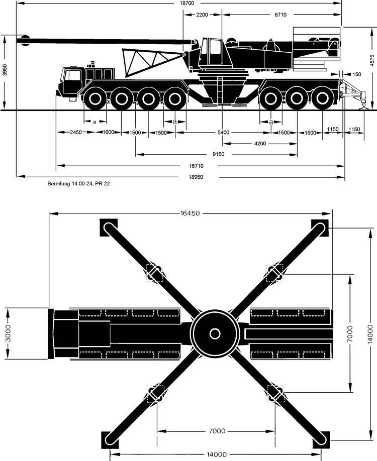

Anybody here who can provide us with the measures and weights of a TC 2000 strut crane from Demag? Need the data for planning the shipping of that crane. |
Veröffentlicht 22.06.2005, 13:04 - 001 - in "TC 2000 Measures" - [418]
This is the measure drawing from the Demag brochure: ![]() The crane has a width of 3m in transport configuration. Measures and weights of the outriggers, counterweights and boomparts are not listed in the brochure. ___ Carsten Thevessen

Veröffentlicht 07.07.2005, 21:49 - 002 - in "TC 2000 Measures" - [434]
Is it the same like the TC1200? Does the TC 2000 have more counterweight, or are they different in other things? ___ Grüße Matthias |

Veröffentlicht 07.10.2005, 16:56 - 003 - in "TC 2000 Measures" - [492]
The both types are rather identic, but the TC 1200 has smaller outriggers of only 10 to 10 m. ___ Regards
